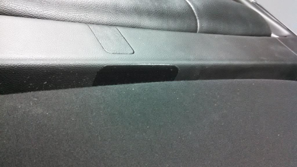

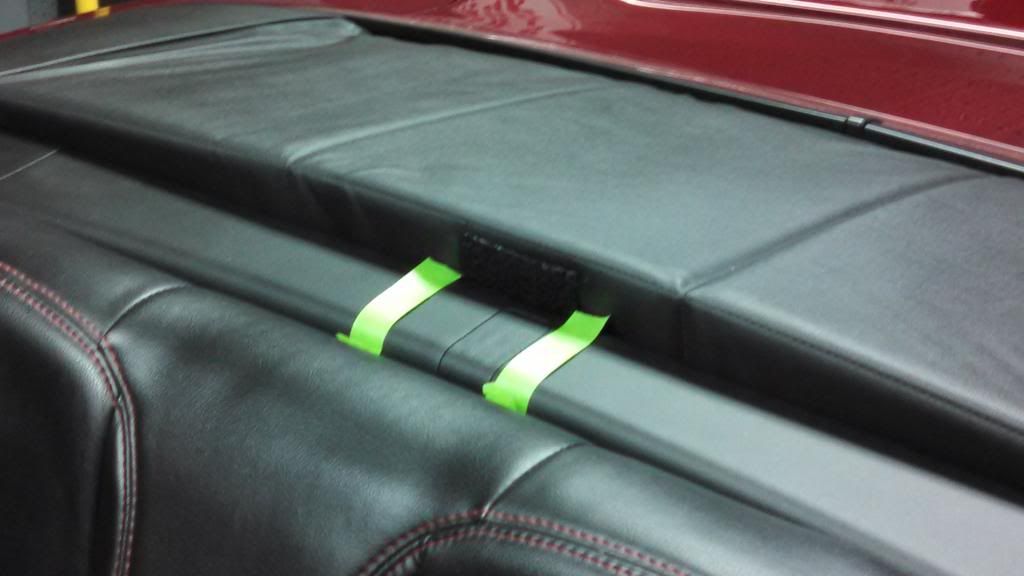

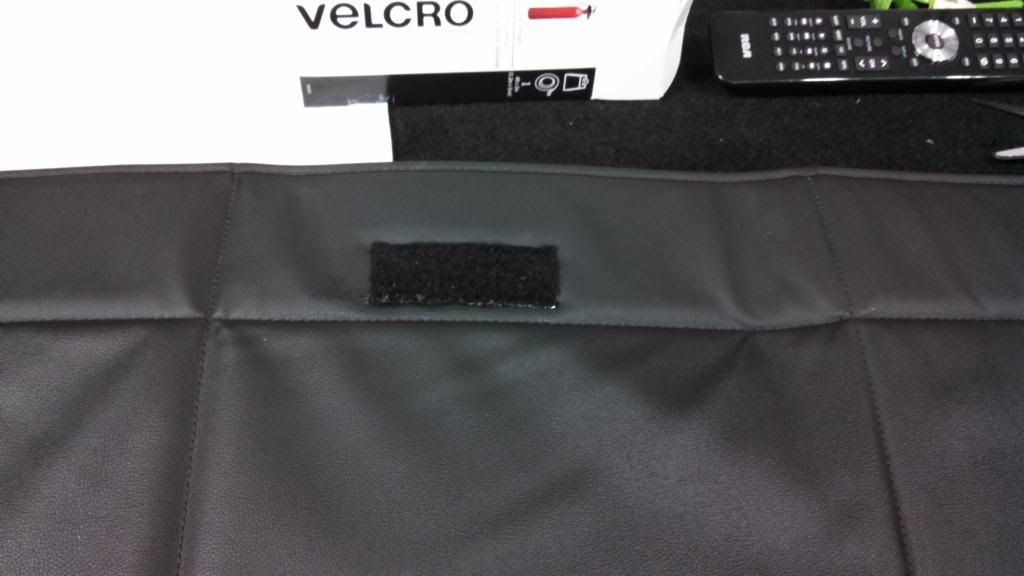

As requested, I'll post the video of "why" I had to fix the tonneau cover raising up issue and a couple simple pics of how to easily fix it. First the Video;
First you will need to attach one half of a velcro strip to the tonneau cover. I highly recommend having this sewn on. You will want to do this on the smaller flap of the tonneau cove; close to the seam as shown below.
Next place the tonneau cover in place on your convertible and mark with tape where the second half of the velcro will need to be placed.c
Next throughly clean the area where the velcro will be placed with alcohol or other cleaner. If using 2" velcro, you'll need to cut it down to 1 3/4" as this is the size of the plastic molding where you will mount the velcro. It is also advisable to "round" the corners of the velcro piece to help keep it from coming loose.
After the velcro has set for awhile (overnight if possible), you can place the tonneau cover back on as normal. You can use your fingers to separate the velcro to either push it down further OR to remove the cover.
This "fix" has kept the cover in place for me, and have had NO lift like occurred in the video above. Hope this helps and gets me some extra brownie points from the vert owners.
