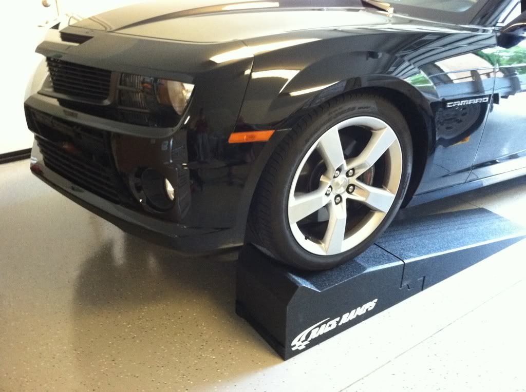

I have race ramps because my car is lowered also. The 40s wont work for you. They have a way for figuring out which ones will work for you. You take a yard stick and from the front slide it till it hits the front tires. Then pick up the yard stick until it hits the underneath of the Camaro and measure how high the end of the yard stick is from the ground. Each of their models has a recommendation of what that height should be. I went with the 67"s so both my cars worked ,but 54s might work for you also. They you have to decide if you want it to be a single piece or two piece model.

Thanks Mojave, the pictures helped me make up my mind!

My pleasure ! Let me know if I can help anymore. And don't worry that they are made of foam. Kind of freaked me out ,but they really rock. Very light and easy to move around and store. Plus strong enough for our cars.
