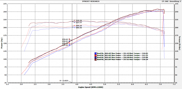

Stock vs Spacer BEST 2 runs each
You can see it looks like both the stock, and with the spacer hit some knock retard in a couple places.. Gas was 92 OCT E10 from a Shell station in the middle of nowhere.
Stock vs Spacer WORST 2 runs each
This makes me wonder if the manifold cooling effect comes into play with the LFX spacer as does the LLT ICEolator. All of the spacer runs are **** near identical where as the stock ones take a dive after the 2nd run.
None the less, the results from the days testing were nice to see.
As far as the spacer, as we've seen before, you (probably) will not gain any PEAK HP, but for most normal people that don't take their car over 5,000 rpms every shift, there is a NICE bottom end gain in both HP and TQ. As previously seen, you do lose a tiny bit of HP from 5-5.5k to 7k rpms, but I know I won't loose any sleep about losing a few hp up there.
I imagine a good tuner can EASILY get it back (if you're already tuned, no need to worry about voiding the warranty, if you aren't and don't want to be, then don't worry about the little loss)...
