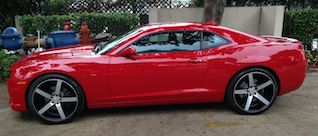

I have to apologize to Apex; I have been overwhelmed with my real job, car shows and starting a car club. Nevertheless, Chase sent me their Washer Tanker Relocation kit and Air Scoop last August. I finally got it installed today. The install was very straight forward and anyone with basic mechanical skills should be able to complete the install with ease.
The car we used is a 2010 Camaro 1SS and already had a CAI previously installed. We also removed the front bumper cover in order to do some other work. While we had the bumper cover off, we also completed this review. The removal of the front bumper cover is not necessary to complete the install of this kit.
