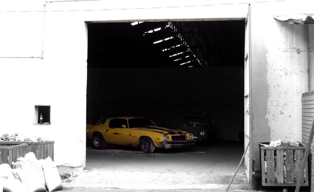

Hi everyone, I've just signed up on this forum after reading through some of the posts!
I'm big fan of the Transformers Movie and am building a replica of the 76 Camaro!
I'm getting there with it, still got a lot to do though.. but I'm happy with how it's coming on! It's got that beat up look for sure, since it's kind of naturaly that way haha!
Anyway, I need your help to tell me what spoiler they used on the Camaro in the movie? I can't seem to locate it anywhere and I want to use the exact same type as in the movie!
Probably you guys know which one it'll be!! This is my first Camaro so I don't really know a huge amount about all the models!
Or if anyone has one let me know!
Anyhow still got to do the interior, change the tires for BF Goodrich and change the rims on the rear so it's exactly like the one in the movie!!
Attached a pic of the work in progress!
Hope you can help, thanks in advance!
Cheers, Marko

Im imagine it is a standard spoiler from the 2nd gen camaros but not sure which one is the same one and which ones will fit?

It should be the same one, but as far as I know, the chin spoilers didn't actually come on the 74-77s.
It looks as if the spoiler for a 76 Camaro can also be found on Camaros from 1974-1981.
I checked 2 parts dealers and they both have new (reproduction) 3 piece spoilers for sale for 74-81 Camaros.

the rear taller spoiler looks like a 70-73 i think the 74 -77 were smaller,front looks like the 79 z28

yeah this front spoiler is really getting me! I've looked at loads of spoilers, but can't find one that is exactly like the one from the movie...

I wish you luck, but I don't think you're going to find that exact spoiler. It looks like a custom deal. The 76 T/As look closer to the end pieces used on Bumblebee:
The 77 Z28s were the only big bumper car to get a chin spoiler, and it doesn't look anything like the spoiler on Bumblebee.
The chin looks to be that of a late model Z28, thats why you have the wheel flare there. and the rear spoiler looks to be from a 70-73 camaro. i think there were two heights avaiable. i belive most of the parts from 70-81 are somewhat interchanable, but things like the back window, grill, and tail lights are not. keep in mind that the movie guys could have made the parts for the cars, as it is not uncommon for them to do that.

If you do a google search you can find a few 1976 Camaro with this spoiler/fender flare/ ground effect.
To clarify, the subframes from the 70-73 and the subframes from the 74-81 are different. The rear windows are the same from 70-74. In 75 they changed to a rounder rear window. Tail Lights from 70-73 were dual round tail lights. For 74-77 they were kinda wedge shaped on the outter edges, and on the 78-81 they were almost like the third gen tail lights. Z28s were only produced from 70-74 and 77-81. Almost all body parts are interchangeable. Alot of people like to take 74s (because they're cheap) and put 70-73 replacement body panels on them (especially the RS style). The interiors are pretty much interchangeable. The dashes were the same design from 70-78 and switched to a squarer, flatter style from 79-81. The Center consoles were different from 70-74 and the same for 78-81s. I believe it was 77 or 78 when they introduced a pseudo circuit board thing that controlled current to lights, gauges, etc. In 80 they actually had something of a computer on board.
