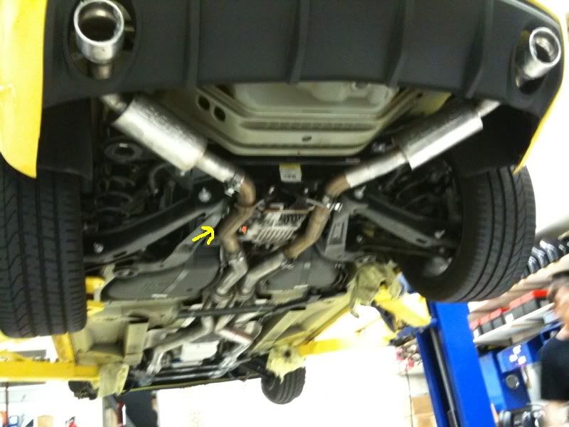

The orange dot thats where the drain plug and fill plug is you can fit a Grapefruit inbetween that Bend you see in the picture.
I took the Diff fluid bottle and put a hose on it where you see the Yellow Arrow I ran the hose over the pipe and into the hole.
I think with using the factory bends this is why im able to work with the Differential. Andy @ ADM said those bends are there for a reason for the factory not just for work reasons but for Certain Flow.
