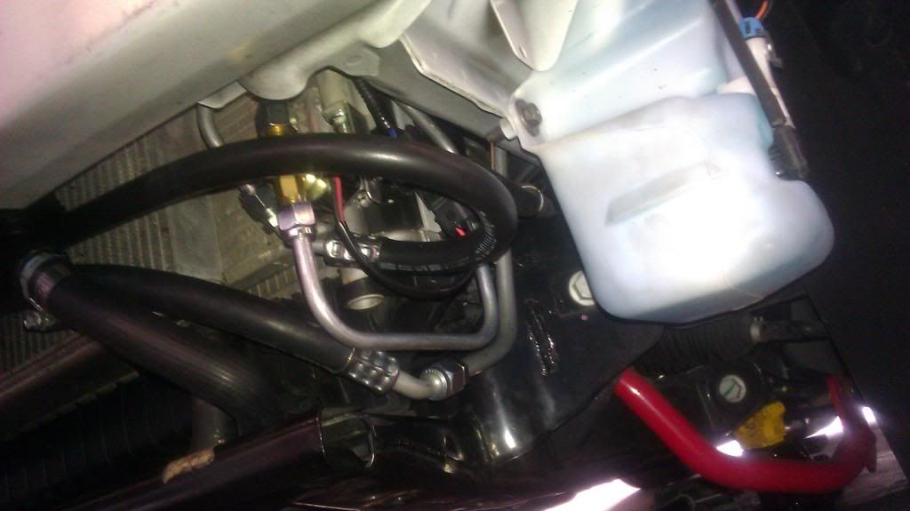

This is the same car I designed the first Camaro Chiller on in 2011 for Turbo99. I removed the entire system and updated everything with the latest design.

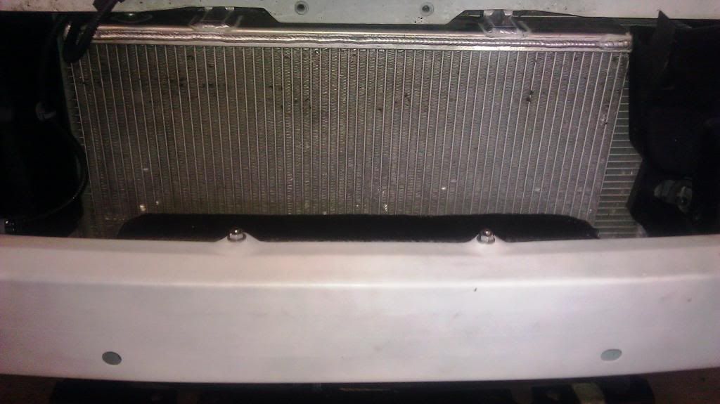

This Chiller is 18” long so thats 50% longer than the original 12”, this thing is a monster and requires bumper modification. Nearly every part has been refined since 2011 and is custom made for our application.

Here are the 3 cores Standard 30 plate, 40 plate upgrade and the Xtreme 18”.
Standard vs. Xtreme Chiller.
Here is a Chiller I removed installed by another shop side by side with our standard 30 plate used since 09. It appears to be a 20 plate which is 1 of many reasons it never worked.
