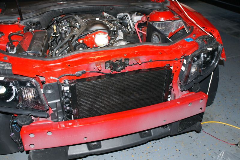

On my convertible there was a brace going across the front of the radiator. I removed to allow room for the inter-cooler. I will see if it fits after I install the inter cooler.
If you have the JDP color changing halos you will have to move the control box from behind the bumper. I moved it to behind the bumper on the right side

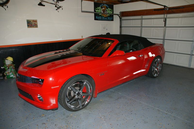

Here are some final pictures.Roto fab covers fit great and look good. I also painted the cross brace black.
Great job installing the supercharger...
Thank you. It was not to bad doing it my self. Felt good when I turned the key and it started right up.
very cool.
your car is gorgeous. the grille and color combo really work well together.

On 91 octane about 585 RWHP or around 700 engine HP. I am running just under 10 psi of boost at WOT.:thumbsup:
