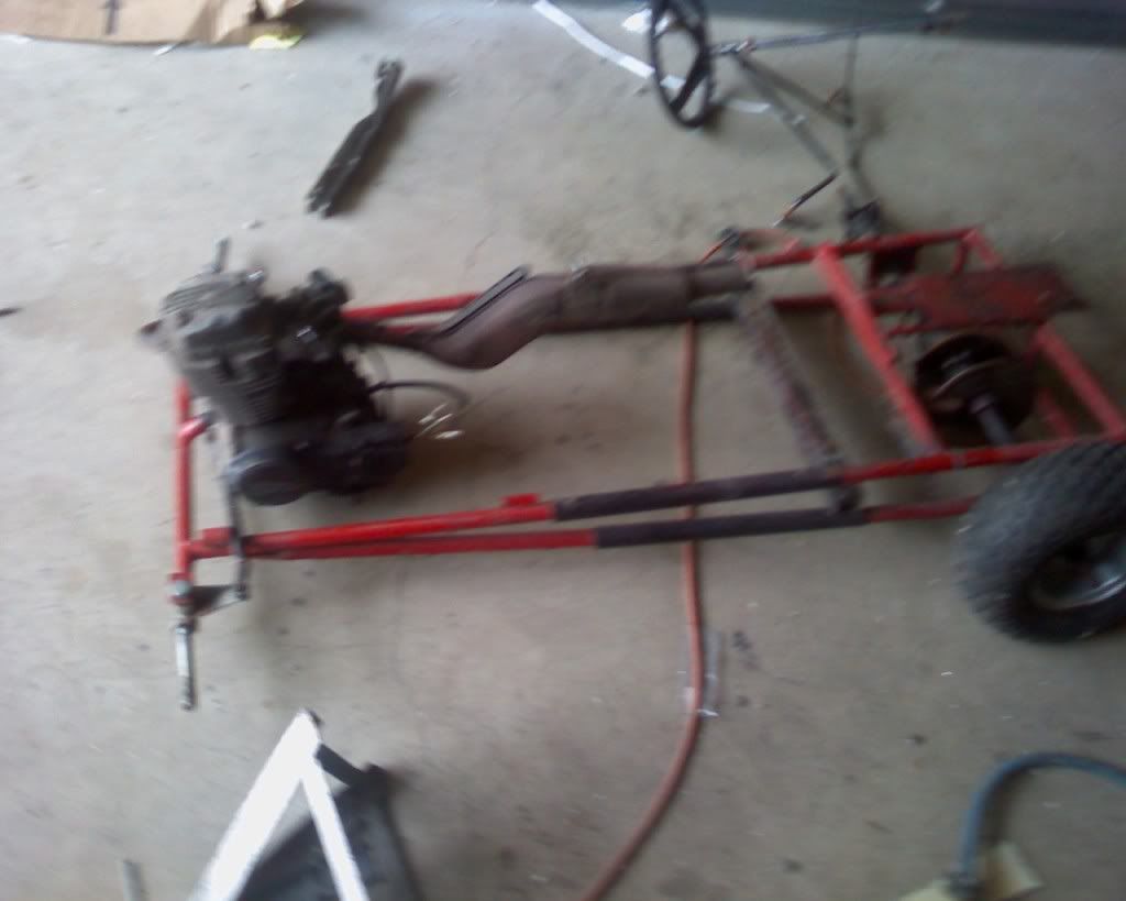

And a bit of a mock up of where the engine will sit ....gotta re run the exhaust.......it will be run under the chassis, and out the back......

if you want the wheel barrow to be low to the ground it would be best to mount the engine in the back.
neat idea though!
6,759 Posts
yeah, why not do a rear mount motor? would be easier to do the driveline to the rear wheels then.
190 Posts
Discussion Starter #6
oh....i already have the whole driveline sketched out in my head....its gonna be motor chain down to the undercariage, where it will go around the forward mid-shaft, next it will run a chain back to the back end of the bucket to the rear mid-shaft, then a chain up to the rear axle. So i will have 3 separate chains in motion: engine to mid-shaft, mid-shaft to mid-shaft, and mid-shaft to rear axle.
the reason for this routing is so it will look more like a T bucket......thats the idea i have in mind for this.
and rear engine will not work, because of the transmission case....i cant run a chain straight down off the output, so i would have to have a MORE complex jackshaft arrangement for a rear engine, and it doesnt fit the look i want.......
