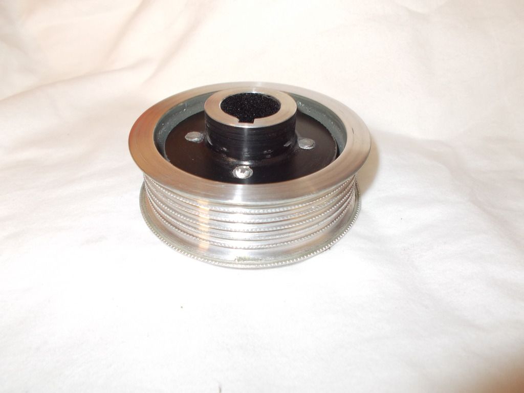

Designed a quick change hub/pulley driven system so the original IPF/KPE owners can use most Magnuson 6 rib pulley's on their existing systems with guide pips to keep belt in line:
Bolt hub on head unit and then only have 4 screws to change in future for upping boost, etc.:

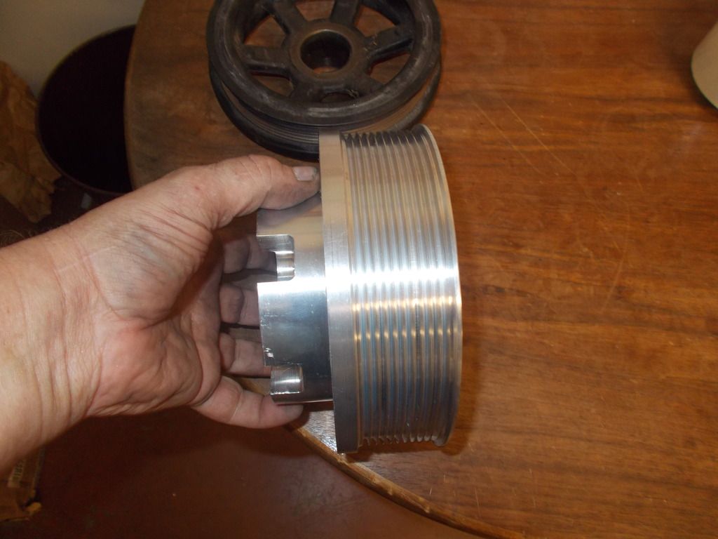

The top mount and the Vortech based new systems use a new pulley we designed that simply bolts onto the stock crank pulley indexing into the spokes so no need to pull stock one to install:
SO all run a short 8 rib belt for no belt slip and not relying on the super long single 6 rib belt that drives all other accy's as well as the SC. Simple, less issues that could occur, and no need to take super charger off to change belts. 2 minutes easy change with new design:
